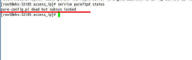

  1. ]# service pureftpd status
  2. pure-config.pl dead but subsys locked
复制代码
