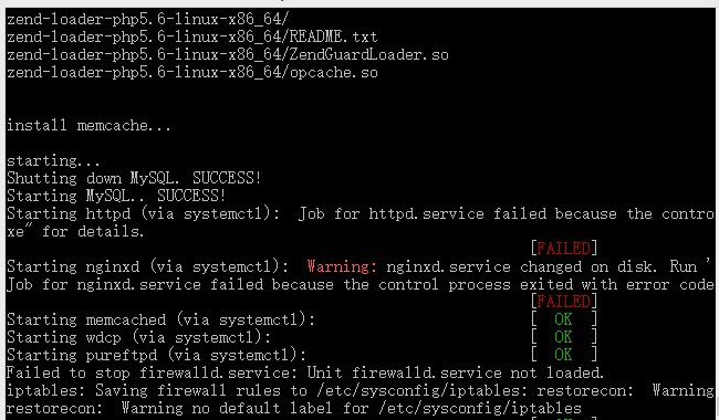

我刚在一台centos的主机上测试,问题依旧,访问不了默认目录
重装,最后有提醒
Starting nginxd (via systemctl):  Warning: nginxd.service changed on disk. Run 'systemctl daemon-reload' to reload units.
Job for nginxd.service failed because the control process exited with error code. See "systemctl status nginxd.service" and "journalctl -xe" for details.
图片附件: QQ图片20160427152230.png (2016-4-27 15:26, 11.99 KB) / 下载次数 22102
http://www.wdlinux.cn/bbs/attachment.php?aid=6024&k=1ce3ead8ec9038aa48d411605e909fe9&t=1793779359&sid=Nk2GI6
作者: admin    时间: 2016-4-27 16:08
修改过哪?
重起试试
